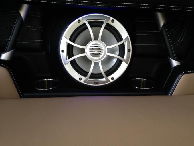

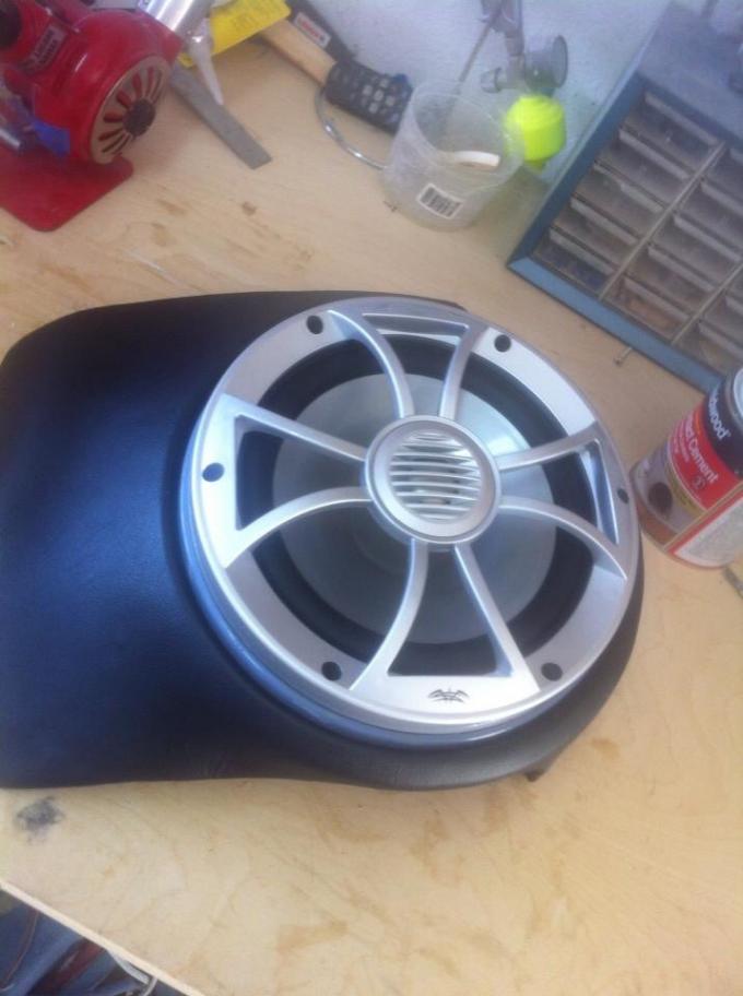

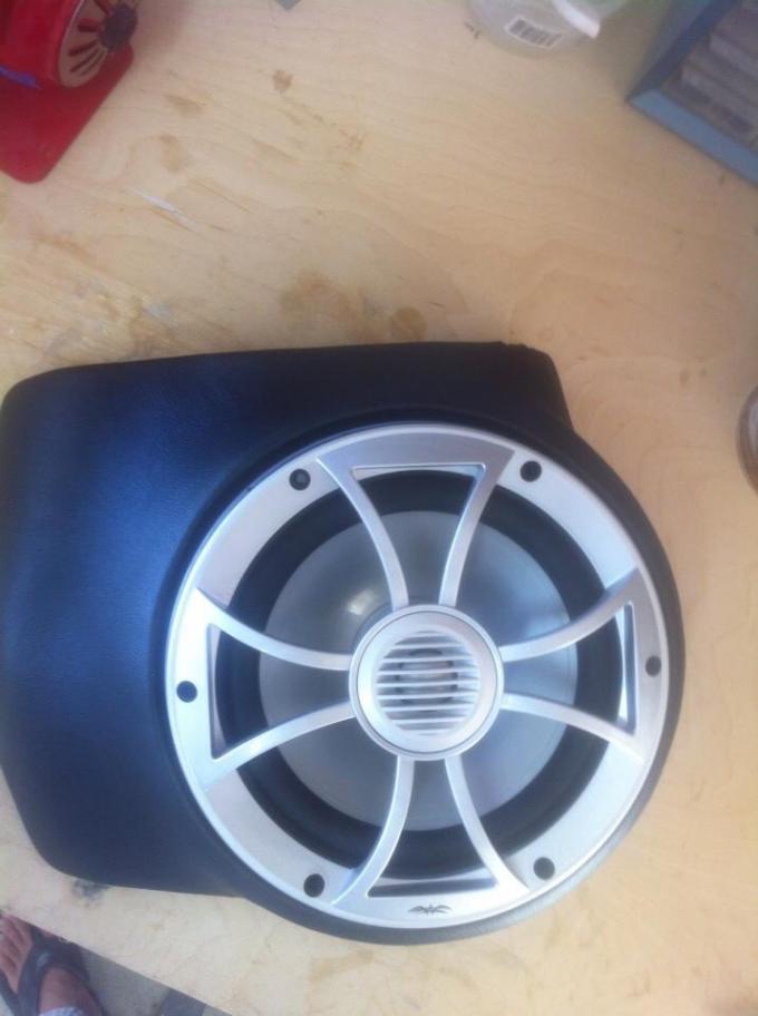

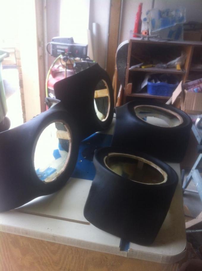

          I did a G23 with Wetsounds 808's in custom glass pods

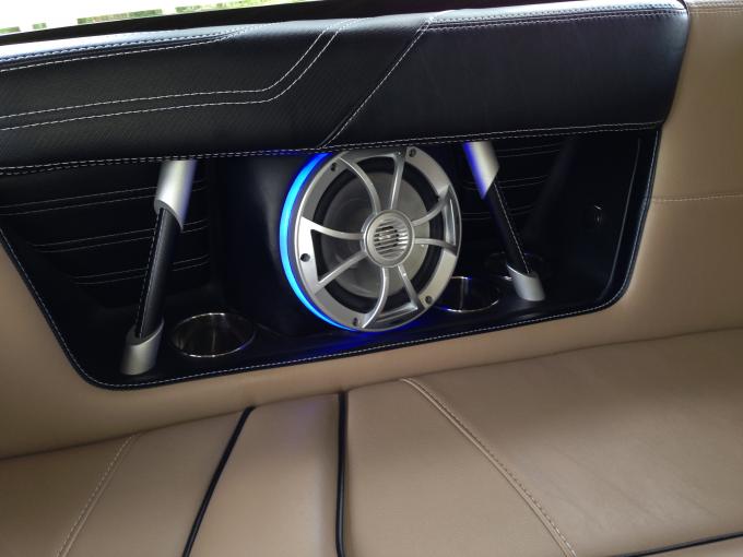

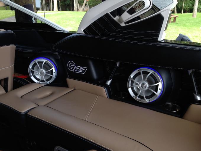

                    Chris,
                    Its worth every penny IMO. Increasing the size brightens, balances and compliments the tower and subs making everything come together. 6.5s just can't keep up with aftermarket tower and sub upgrades. I have had pods built for two G's and seems like a huge pain in the ###. The bow pair are simlar in shape, three in the main cockpit are similar and the one behind the driver seat is unique so imagine fiberglassing all the different ones. Not worth it for an installer unless you pay a high price or have them do many other things. Also, you can have them made so that they screw into the OEM holes for the 6.5s so if you upgrade boats you can remove the pods and easily put the 6.5s back in and move on. Legend marine audio in Houston did my first pair as shown above and Hydrotunes in Austin did my second. Legend does some badass custom work and I have seen more pods come out of hydrotunes because Austin is a different market with more higher end stereo upgrades. Both put out some of the best work I have seen.
