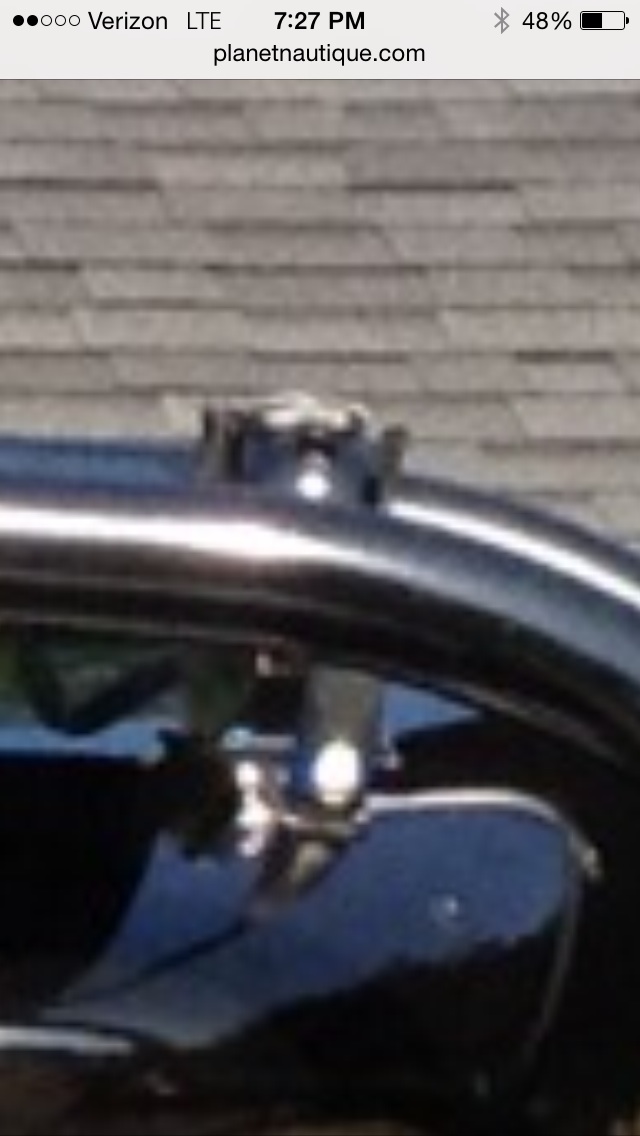

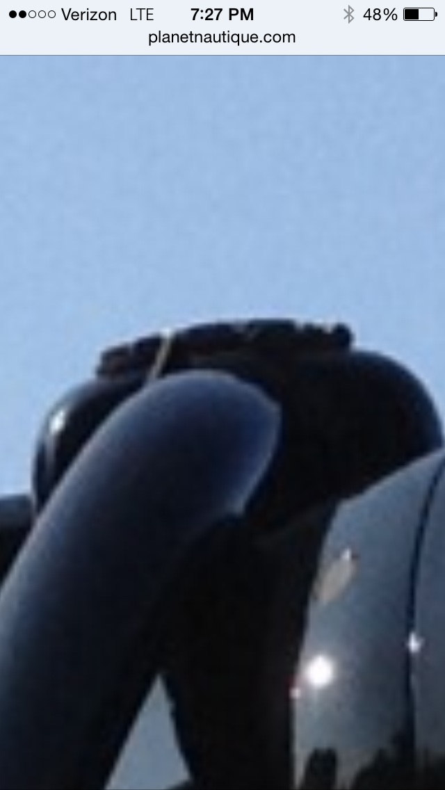

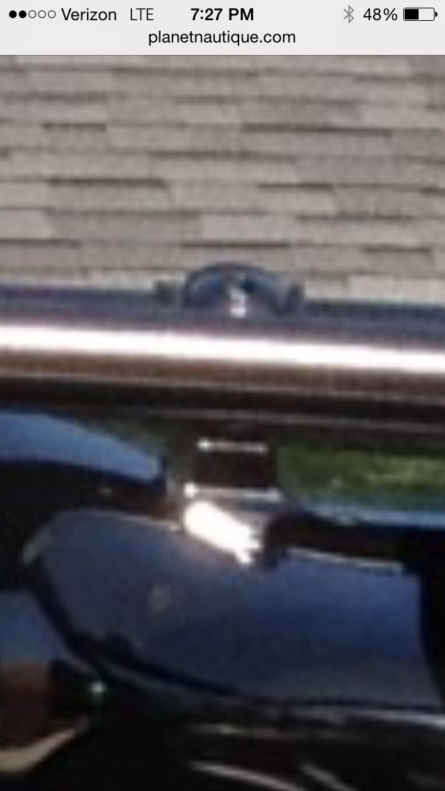

            Core-rider- I have studied these pictures on another rev410 forum. This is how I know it is possible to mount these on this model tower. Side note, I like how your iron cross has been turned, I've never been a fan of the iron cross, or the chrome.. I hope u don't mind, but I will probably copy that move. I love the boat, I've always wanted an all blacked out Nautique, and hear I am with my all white boat haha. So my speakers are white, with blacked out grills. We do indeed have the same tower. And as I've studied your pics, and I could be wrong but it does appear that u have the 2012 yr range swivel on the outer clamp of your pod. That is what gave me the idea of adding swivels. Leaving the inner clamp fixed and the outer swivel, I was hoping that would clear things up. The new style swivels do not have that "sprocket" thing on top. Again, I could be wrong on this, and if you indeed have all fixed mounts and I was mistaken, it's kinda back to the drawing board with either paying the money and trying the longer swivel clamps, or fabricating a spacer like MLA mentioned. I will attach some poor quality photos that I screenshot on my phone of your set up to show what I was talking about.

                All of my clamps are fixed. I guess there was just enough variance in the towers to cause fitment issues. Believe me I was worried for a moment. At first I tried mounting mine closer together, but because of those same bars running bow to stern the speakers would have overlapped one another. That made me move them out and that caused some worries for a few minutes as well. It sounds like your best/cheapest option is building a spacer.

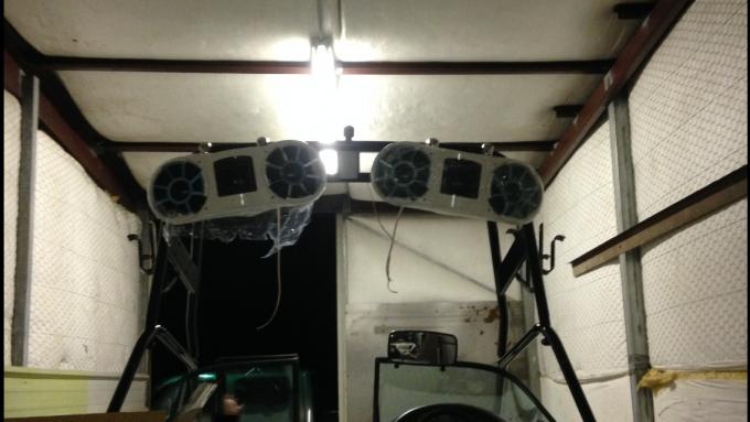

                        Swivels worked! Although I need to replace the inner clamps with swivels as well to drop them down. I didn't think they would be cocked that bad. So I'll get another pair of swivels to even them out, dismount them and send the grills and clamps out to paint. I will post a pic of the finished product upon completion. For now here's one pic. Just keep in mind that they're loose in here and not adjusted so they look really funny.
