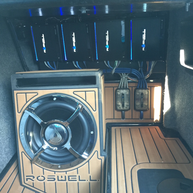

      Roswell makes a sub box for their 12" sub that fits the G perfectly. They perfected it on my G23 last year, and it is now available to anyone. The kit also includes a vent that gets installed under the passenger seat. It is a VAST improvement over the stock setup. If you're ever over toward Lake Norman, you're welcome to check it out.
      There are other companies that make better subs than the stock Polk, but this is the cleanest execution I have seen in a G, and it sounds great.

        Jeff, is the box and sub sold together as a kit? Or can you buy just the box and put any sub in it?
