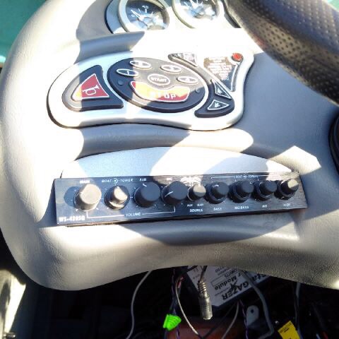

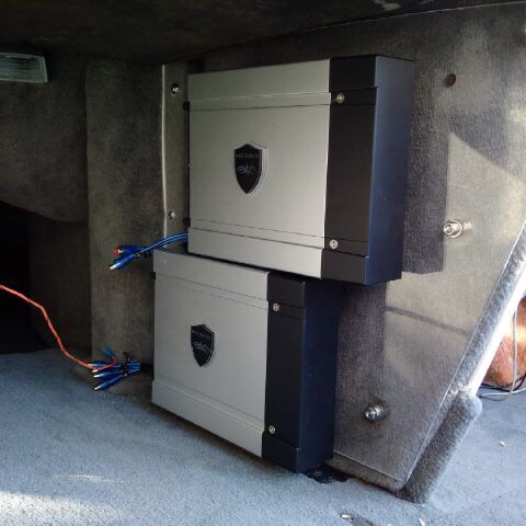

          A few upgrades to my stereo system over the last week. Now to mount two amps and the wiring.
          With regards to the wiring should inreplace what was previously in place for the stock speakers??..I'm no electrical/wiring professional by any means. While on the topic is there anything special i should consider when wiring the speakers/sub to the amps, then amp to the equalizer, then to the additinal battery. I.e. wire gauge, grounds, additional fuses, etc etc.

              I have a few more photos of where the amps were located, and the 420. A little more moulding was done to finish off the 420 equalizer.
