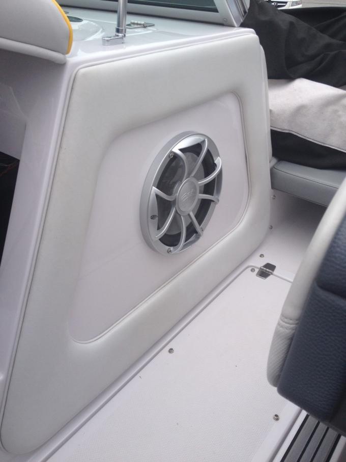

    I've enjoyed mine in the walkway. used Advantech flooring to stiffen up the panel after cutting the hole. the only problem is everything in the glove box rattling. other than that it rocks. it is an ib jl 10.

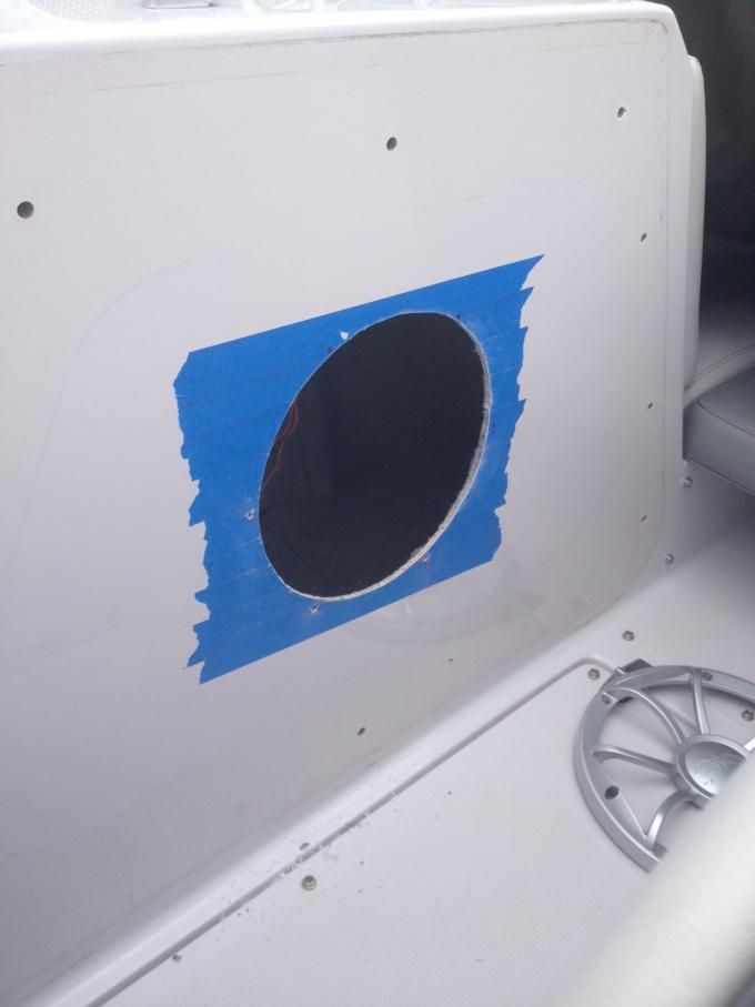

      I was in the same dilema. I ended up cutting out the walkway and putting in a Wetsounds XS-10FA sub. I really did not want to lose the storage with a box so I thought I would go this route first with plan B being that if I did not like it I would buy the hatch/ door and put it in and then build a box. As ski4evr points out you need to use a stiffening material on the inside wall of the walkthrough as my sub can really move the fiberglass which i am sure is taking away from the subs performance. I am going through my entire system this winter like you and will add the material then.

        Swat--I never tried an IB in mine. Rather, I cut out a good part of the passenger walk through panel to vent the area and tried both a sealed and ported box with a WS XXX. It worked well...but you really felt it in the observer seat. I don't know if an IB sub would solve that issue. Overall, I liked the sealed box in that location. I'd say the overall feeling of bass was greater with the ported enclosure but I liked the tighter sound I got from sealed (and a little less rumble through the observer seat). With the sealed box, I was able to push the enclosure pretty deep into the space--I believe the box was 14.5 inches deep and I pushed it all the way to the back of the bow seat, so there was still a lot of storage.
        Doing it over, I'd lean toward stiffening the pass through panel and trying an IB. They aren't that expensive and worst case is you move to an enclosed driver and use the hole you cut as a vent...there are plenty of ways to make the vent look nice. Mine was pretty cheap: I covered it with a double layer of speaker cloth. It looked OEM. The only downside is that speaker cloth fades over time, so it needs to be replaced every few years.

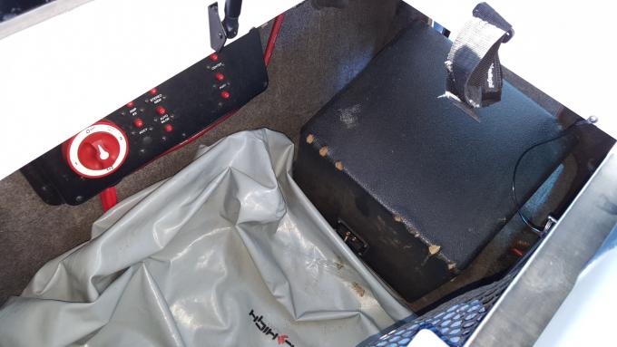

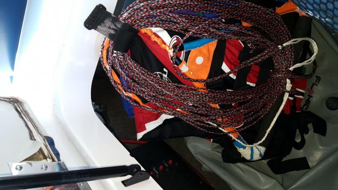

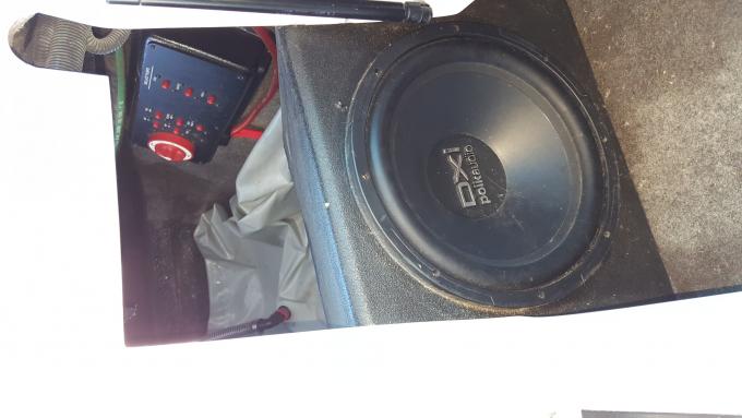

              "Certainly if you are mounting a sub/box within the locker you can get a nice increase with a 12" driver versus a 10", but with a greater loss of storage."
              Here is a little food for thought. Over the years I have moved the sub between 2 places. In either case mine is a 12" vs 10".
              Under the loveseat. Little better bass sound, but can't place fat sac here.
              Behind port stern seat leanback: Allows for placing fat sac under loveseat for maximum lean and fantastic surf wake. No loss of storage, and can still fill 1100 sac nearly full. More then you can possibly need.
