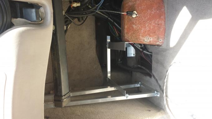

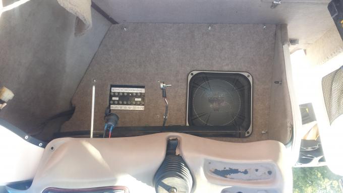

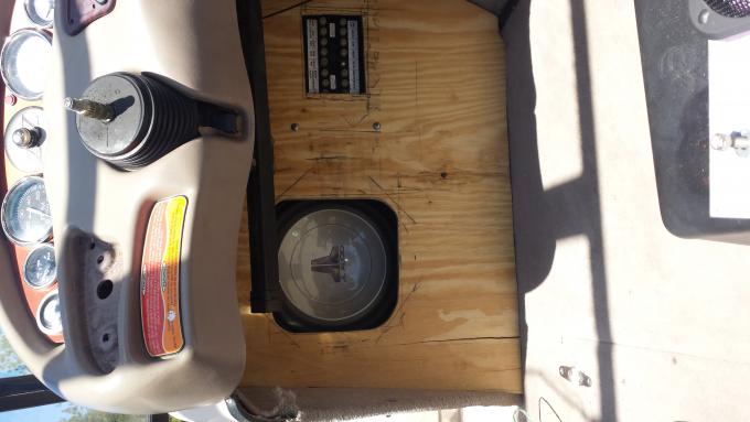

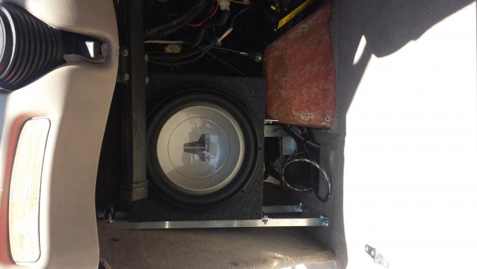

    I just installed 10 in sub in the box and I wanted to share the results of my work. I picked starboard side as a location. Made a very sturdy frame from L-shape aluminium and used s.steel hardware. I mounted the mono amp on the top of the sub box and it fits there perfectly. Then I tidied up wiring a bit so it is not on the way. I also moved breaker box a bit to right. I used regular plywood but then covered it with 3 coats of waterproofing membrane and then carpeted. Attached wall with few wing nuts so it can be removed easily anytime. At the end used square sub cover. Hopefully you ll find the idea interesting.
    I will be installing my new WS HT4 amp on port side soon to power tower and cabin speakers and have some ideas also.

          Sorry for crappy pics in advance, now Im trying to post them straight from my phone
