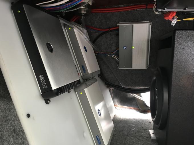

          David Thanks for the guidance. Your right JL tuned up nice. Followed what you suggested starting with check speaker and followed through. Sounds very good now. That's what I love about this forum, while my install is not as pretty as some professional installs it sounds great. Thanks again for everyone's help!!
          the old amp board will get swapped out and reorganized at some point but I'm set t go enjoy it!! I'll take pointers if you have suggestions, but I was trying to keep amps as far away from each other as possible.
          leason learned...... Tuning is everything!!!!!
          Thanks again!!

            Never,
            Glad we made some headway so you didn't discard the best amplifier for the job.
            Yes, tuning IS everything. But we only applied a band-aid based on a little anticipation taken from your comments, and are a long way from a real professional tune. Again, that's a job for a supporting dealer.
