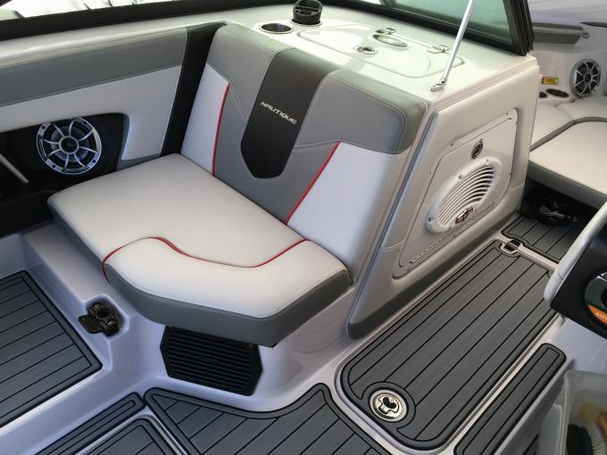

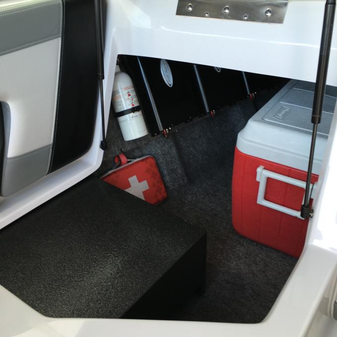

                        Originally posted by cedarcreek216 View Post
                        I decided to go a completely different route. Like David expected, there was not enough room to get a proper enclosure in the void under the steering wheel. I still did not want to give up much storage so we went with a 8" Treo sub with a 1000 watt Treo amp in a ported enclosure tucked in the very front of the storage under the passenger seat. It sounds incredible, particularly for an 8". The installer wanted to louvre the access door for more venting but knew I was not hot on that idea so did the vent right in front of the sub and port. I will end up adding more vent surface at some point as it is a little restricted with the current vent surface area.
                        With all the restrictions I put in them, I could not be happier with the outcome.
                        This looks like an awesome solution. I did something similar, but with a JL Audio 13tw5. But I have been curious about how the 8" subs would do in there ever since my son put an 8" JL ported sub in his truck that is incredible.

                          scarbs,
                          I have also done a down-firing slim-line 13.5" sub under those same conditions. It was very good but not outstanding considering the size of the sub. A slim-line sub is inherently a little less sensitive with a little less excursion. Down-firing also reduces the radiating surface area which is costly to bass energy. All issues that would never be exposed in an enclosed vehicle cabin.
                          In that same space, using the JL Audio 8W3 in a side-firing bass-reflex enclosure would be impressive, and surprising for an 8". Using two 8W3s would be even better. Standard deep architecture sub drivers are preferred in open air use.
