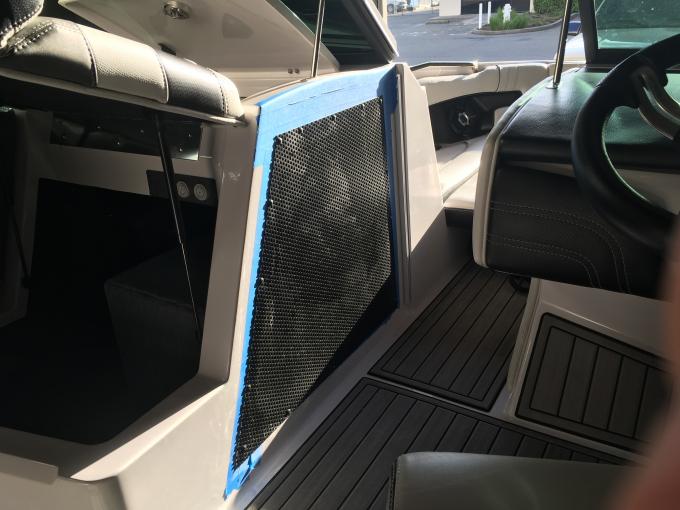

                        So the project is almost complete. The original plan was to 1.Open the walk through 2.Open under the observer's feet like most people do 3.Maybe open more areas. 4.Flush mount a Wetsounds 420SQ on the driver's side.
                        I stopped by the shop today to hear what it sounded like after only opening the walkway. All I could say was, "WHOA." It made a HUGE difference. No need to cut any more for now, that I can hear. It relieved the bass pressure considerably and I can tolerate sitting in the observer's seat much more now with it cranked. Most importantly, the bass SOUND now travels well throughout the cabin. Before today, I had to open the observer's seat to hear all the sound from the subs. It also felt like a bass port whenever I pulled a drink holder out of the side. So so so much better now.
                        The new opening was cut within about 3" of the edges of the area if that makes sense. They're making a whole new upholstered panel with 1/2" starboard backing and matching vinyl to replace the stock panel with the trash door. I'm also saving the fiberglass piece they cut out so the whole thing can go back to stock whenever I sell it if the buyer would rather have it stock with the trash can. I'll try to post pics when it's all finished if I can figure out how to post pics.

                          Hey I think I figured it out! Whoopie! Here is a progress pic of the opening and the aluminum mesh that I had powder coated in satin black. Everything is dusty on the boat right now. Stay tuned for the finished product.Click image for larger version

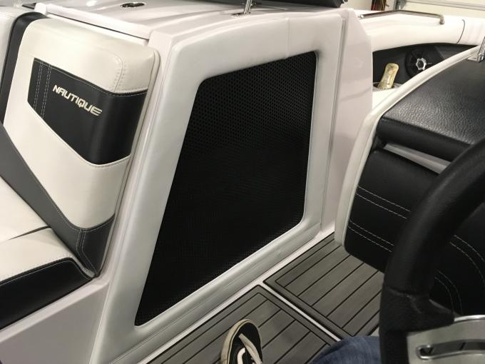

ID:	518260 Round one. Not happy with the color match. To be continued. Waiting for the factory upholstery to arrive next week.
