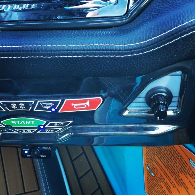

                    Click image for larger version  Name:	volume control.jpg Views:	1 Size:	74.5 KB ID:	518001
                    This is a pic from Jeff's old G23 with the roswell zone control....Mine is mounted somewhat where the sub control knob is in this picture (under the start button) but a little further back and flush with the under helm fiberglass. Just some ideas....

                            Here's my RLC install (I'm pretty sure OKWAKEBDR copied me):

                              Here's what it the Roswell knob looks like on the left hand side. Depending on your personnel and need for control, you may or may not want the knob within reach of anyone besides the driver. With my personality and crew, the left is a better option.
