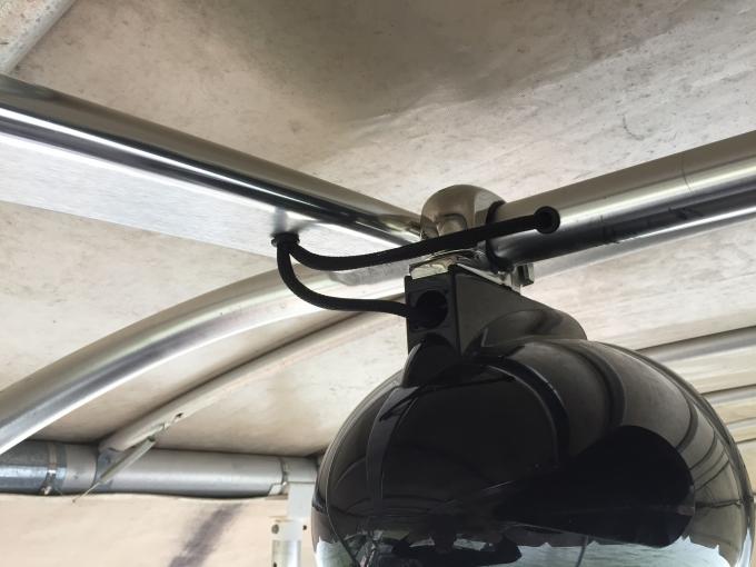

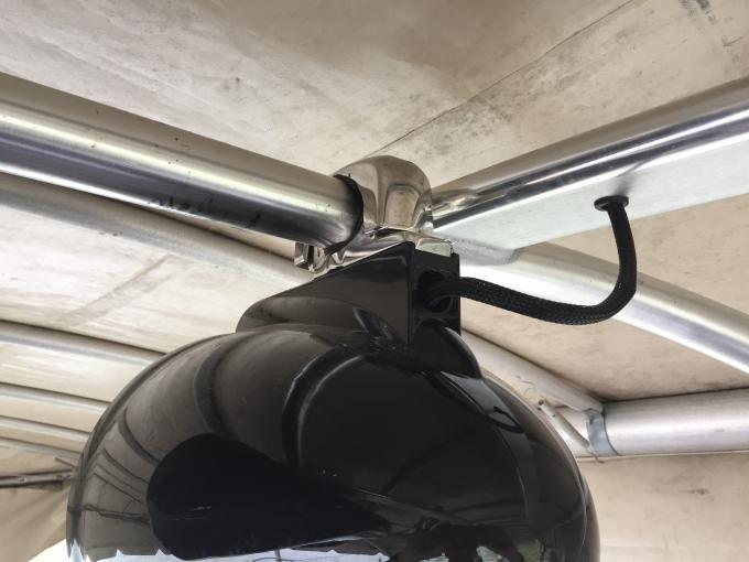

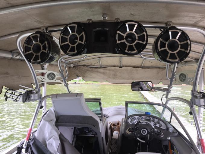

      Got the install finished this weekend, figured I'd close the loop with some pics if anyone else needs this info down the road. First the final install:
      As I suspected there was no access hole between the flat support bars and the rear round cross bar. In the picture below the wires for the REV410 run alongside the anchor light wires up the from leg on the left of the picture, then the speaker wires pass through an existing access hole between the left round cross bar and the flat support before existing out the rear grommet to the right alongside the driver side REV10 wires.
      They then go from this existing grommet into a new hole I drilled into the rear round cross bar and then pass through a second hole I drilled into the clamp of the 410. The wires for the driver side REV10 still go through the rear access hole as the previous owner had setup, haven't decided yet if I am going to add a Neutrik still connector to clean it up or pass these wires through the rear cross bar as well like the 410. Still working on finding grommets that actually fit 1/2" holes for the tower correctly.

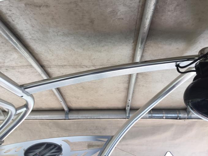

      The port side REV10 remains the same just cleaned up with braided expandable wire sleeving. Again, the wires travel up the front leg of the tower on the port side, then pass from the front round crossbar directly into the flat support in the picture, but no matter no much I tried with floss and the vacuum and stiff fishing wire, seemed there is no access hole between that flat support and the rear round cross bar. Looks like I would have to do the same on this side as I did on the driver side for the 410 in order to get the wire to pass directly through the REV10 clamp into the tower.
      Still don't understand why the tower came with access drilled between the front round bar and the flat bars, but not between the same flat bars and the rear round bar.
