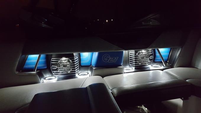

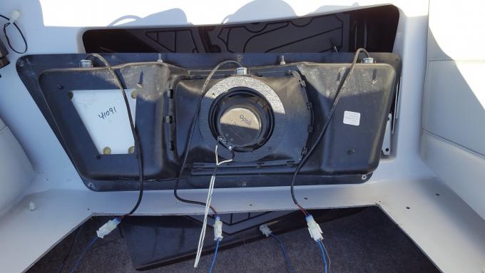

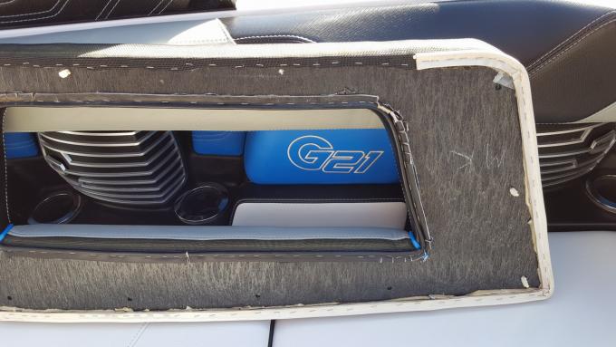

      In my opinion you have to figure out what stock in boat speakers you have? I have a g21 2014 and they were the bottom of the line polk. I actually like polk but NOT those speakers. So there was no way I could ever get enough volume (with decent sound) while on the lake wakeboarding. They were fine in the garage or boat lift, which is probably how they sell them (showroom).
      The head unit is fine, and frankly the amps are fine for the volume I need. I realize if I want more volume I need more powerful amps.
      I replaced all 6 cabin speakers and the sub with wetsounds
      xs-10fa-s2v2 1 $169.00 USD
      xs-650-s (3 pairs ) 1 $419.95 USD
      But what I did is I removed my tower speakers, and re-purposed the existing polk amp that ran the tower speakers to just run the bow speakers bridging 4 channels to 2. Then replaced the polk sub with wetsounds 2 ohm instead of 4 ohm. So the other amp powers the 4 main cabin speakers and the sub.
      Sounds pretty **** good. Now I have enough clear good sound and volume while riding. Like I said any louder and you need more powerful amps. I believe I am getting as much bass as possible out of a sub in a free air setup.
      Thanks to MLA for all his help along the way...And to Wetsounds over the phone.
      P.S. I have to agree with David that going by ear is sufficient. I have seen my buddy who reps for Rockford Fosgate tune multiple systems by ear.
