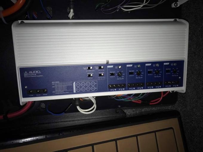

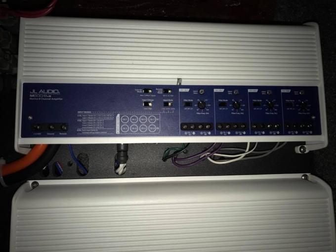

                          post a pic of the RCA connections at the amp.
                          • etang789
                            • May 2009
                            • 155
                            • Hong Kong
                            • 2017 Super Air Nautique G23
                            These pictures were taken before I have made any adjustments to anything and corrected the tower speakers were wired without being bridged.
