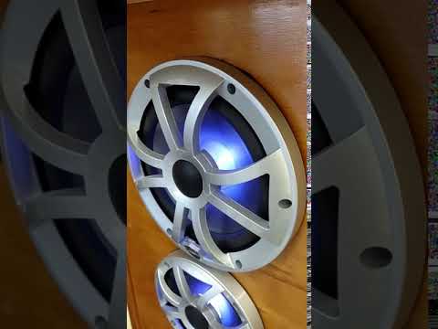

                            Charles,
                            Here is the best i can provide right at this moment. Just speaker LEDs dimmed by an RGB controller. Its a pre-programmed dimmer value as opposed to a variable value like through a rheostat. I do not have a dimmer knob for single color LEDs on hand at this moment.
