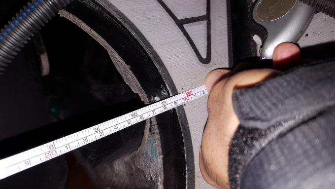

              Yep, I would be curious if anyone made the opening bigger. Last year I replaced the stock 10" with the free air xs-10. I had planned to put in a 12 but it was tight. I can't remember if I bailed ultimately because it wouldn't fit or if I just didn't want to cut the sea-dek, or got lazy. I am old, and can't remember.
              I will say that even the properly powered wetsounds 10" free air as good as it is, sounds worse then my old boats cheap 12" polk dual voice coil which was in airtight enclosure.
              Others can weigh-in but I think the enclosure is the bigger issue than the sub size. I am personally some what disappointed that nautique did not simply make the existing space airtight. It would be easy to do as part of the engineering and build process.

                Tuning an IB woofer has a lot to do with its success. The insulated locker (never said it was air tight) also hurts. You also need to drive the XS with some solid wattage. The Polk 5 chnl is capable of 400W rms but you need to go with the 2 ohm 10FA.
                A 12 will fit, but you are likely cutting the hole offset not symmetrical around the original hole. Trace it right and a new razor blade will make clean work of the sea dek so once you mount the new woofer, you dont know its been trimmed. Heck, its amazing how many G's ive seen where the factory cut the original 10" hole WAY OFF and the factory woofer was mounted over the sea dek on one side, leaving an air leak.
