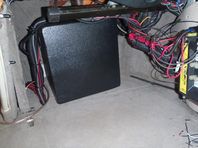

            2000 with 12" woofer in sealed enclosure behind helm wall

              Great pic...can you please help me with orientation? when i am looking at the sub how am I facing on the boat? (bow, starboard...)
              Thanks!!
              Otto
              • MLA
                • Dec 2009
                • 1312
                • Lake Wylie NC Area
                Woofer is facing the outside wall

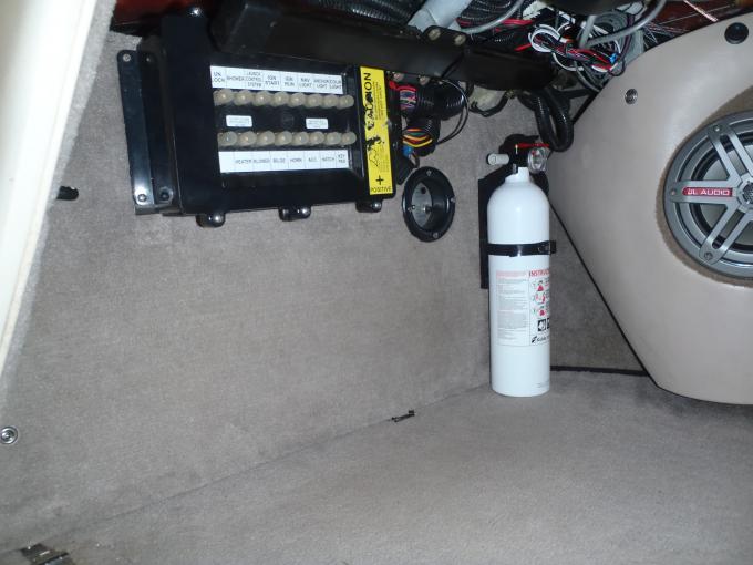

                    So the sub is where your right knee would be when driving the boat...correct? Must be having a Blonde moment!

                      Before the facade was put back in place
