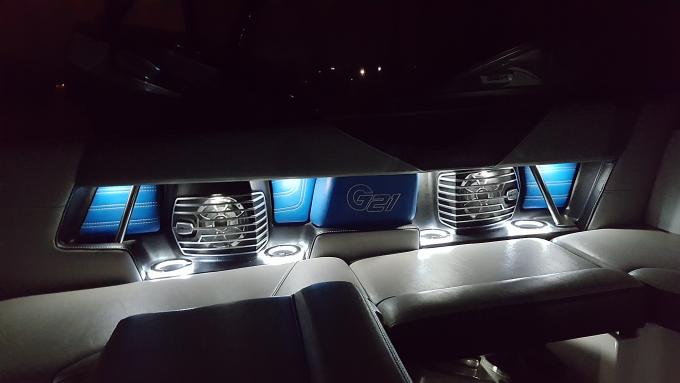

      https://www.planetnautique.com/vb5/f...rills-on-a-g23

        Thanks Smindustries this is helpful. Looks like they made custom pods (assuming fiberglass?) that mounted to the OEM locations. Looks like a LOT of work to go that route. But it also looks like it's the depth of the 8" speakers that's creating the problem, not necessarily the grilles. Wonder if spacers of some sort would work for the 7.7" speakers. In that article they did REVO 8s from WS

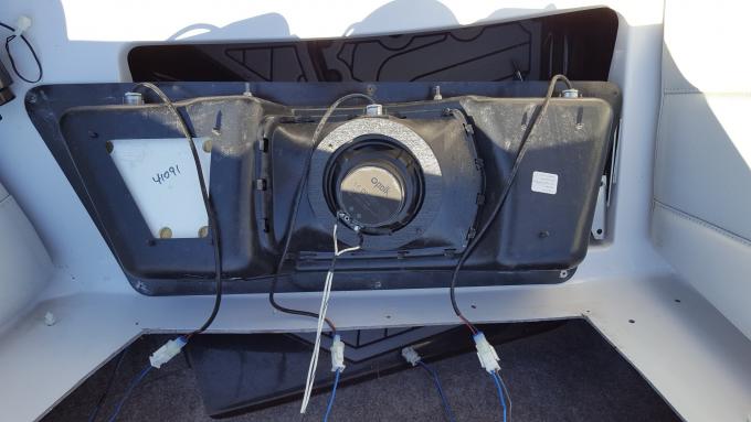

          The molded "pod" the 6'5 is mounted in behind the grill, will not accommodate even a 7.7.

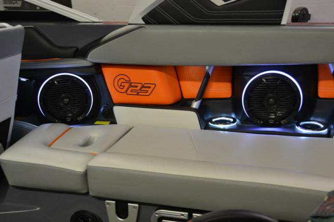

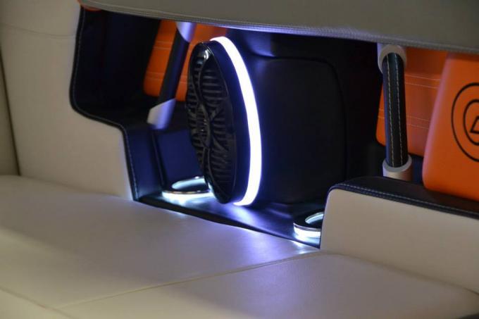

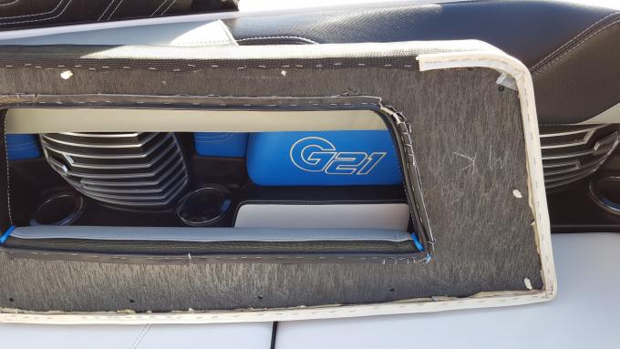

              A buddy of mine had some custom pods built and 8" coaxials put in his 2014 G23 a few years back. Jon Bauer at Pro Installz mobile and marine in Paducah, Kentucky did his install. It sounded incredible

                JRW160 thanks for the pics! Looks great and I'm sure they sounded incredible. Wonder if they have they still have the measurements/molds!

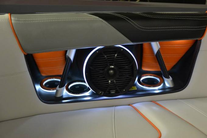

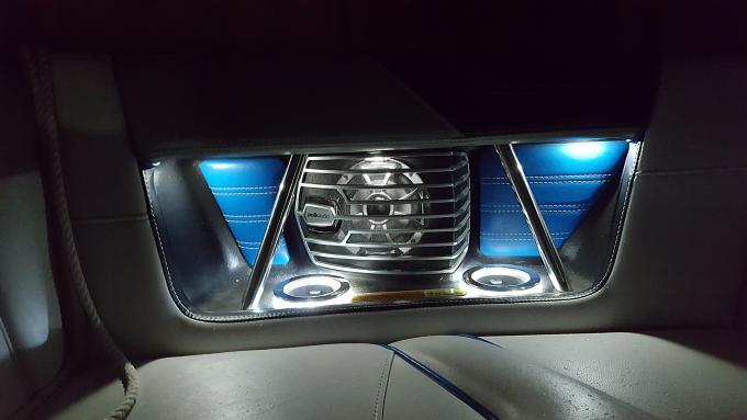

                  Here is how mine came out keeping original look. And here are some pics that might help. Click image for larger version

                      Yeah, I asked wetsounds if they had a badge i could put there. But they said nope, they didn't have anything.
