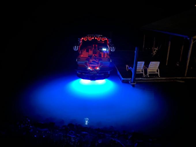

Doesn't have to be the same form factor. There should just be a hole in the hull for the wire.
I use the Roswell Nightwave lights.
https://www.roswellmarine.com/product/nightwave/
There are a number of brighter lights, Liquid Lumens, Shadow-Caster and Lumitec being a few of my favs. Expect to fill some of the existing holes, and make new holes. Expect it to not be plug-n-play. The OEM PDM and wiring may not be able to handle the current draw of your new light choice, so steps need to be taken to prevent burning out the PDM.
