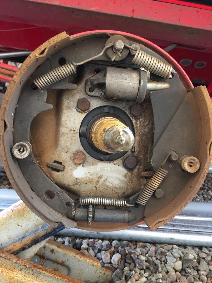

    Hi, I need to service an 08 Ramlin twin axle drum braked trailer however am struggling on ID'ing parts.
    I need to replace the following:
    Wheel Cylinders
    Brake Shoes
    Bearings
    Seals
    Axle tang washers

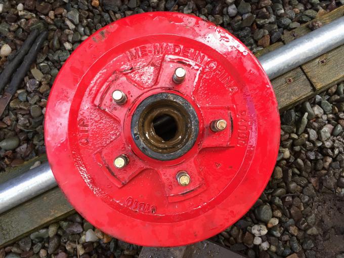

    I've pulled the outer bearing but no p/n on it, I haven't had a chance to drive the race out yet so hope the info is there.. If not I'm kind of stuck!
    I have no clue as to which shoes to purchase, along with the brake cylinders. Can anybody ID the correct parts based on these photos? Thanks!!

    Okay, looks like I have found the brake assemblies. The trailer actuator is made by Titan so stands to reason that the brake assemblies are Titan also.
    https://www.etrailer.com/Trailer-Bra.../T4071500.html
    I just need to identify the bearings and seals and I'm good to go!

      You've got the right idea replacing the whole assembly, that's what I did on my last trailer. You want the free-backing like you had, I bought the galphorite (sp?) version for added peace of mind as it was only a little more. If you can't read the number, measure with a caliper. I don't trust my memory to tell you the right size anymore. You want to get bearings with the double lip seal for marine use.

        I just did this on my 2005 ramlin. I pulled the drums and did a disk brake conversion. I very happy with the way it came out.

          I cleaned up one set of bearings and one grease seal and took to Napa store. They matched the bearings and seals no problem. Got my complete 15 inch 5 bolt brake assembly with Backing plates on amazon prime for $45 each.
