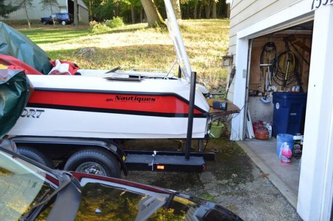

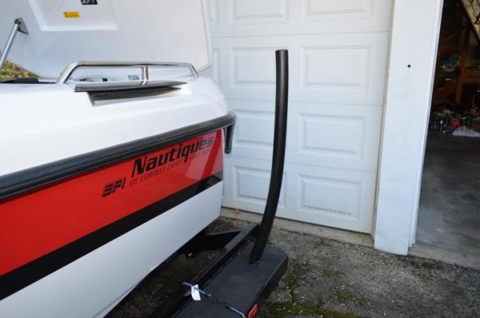

        I have a Super Sport on a 2013 Phoenix. Never had an issue with the fenders since they are heavily carpeted. I do have concerns about the prop and it's guard since the guide poles are mounted all the way at the back of the trailer allowing the boat to move sideways once it's all the way forward. If the poles were moved up 2ft to just behind the fenders it would keep the boat centered better IMHO. I wonder if this is the same issue you are having? I only use it once a year so it's not a big deal,just have to take my time loading. Also don't like the roller up front,I would rather it had crash pads.
          • gary s
            • Mar 2015
            • 334
            • Algonquin IL
