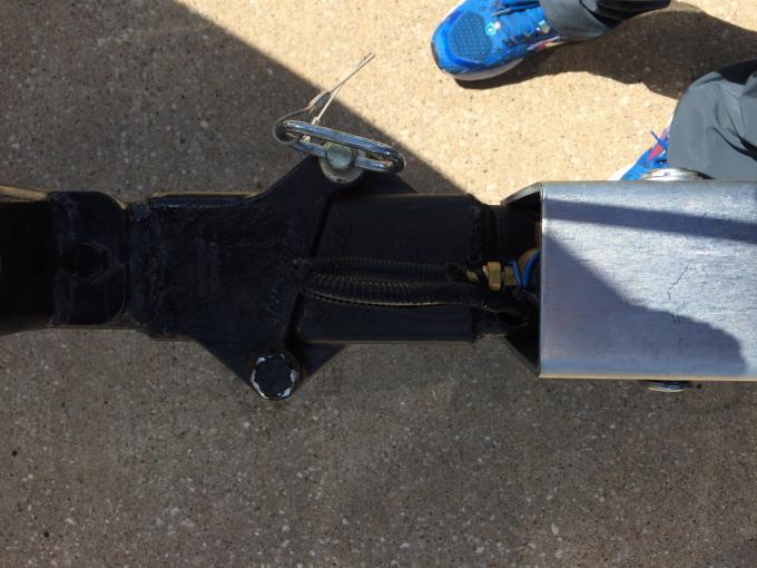

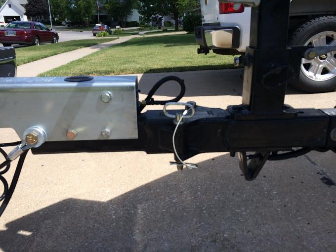

              I will get photos shortly. I got another piece of 3x3 to use as the extension for where the brake actuator bolts on. I would, if you haven't already, convert over to disk brakes while your at it. Did mine this year and wasn't hard at all. Plus I hated messing with drum brakes.

                    Thanks for the pics, I was planning on putting the hinge between the bow stop and trailer. I may need to rethink my plans.

                      Yes, you need to have an actuator for disk brakes to also include one if your have single axle or dual axle brakes. I have a dual axle trailer but only have brakes on the front axle. I would find it tough to have the swing away between the bow stop and the trailer, it will need to be in between the bow stop and the tongue.
