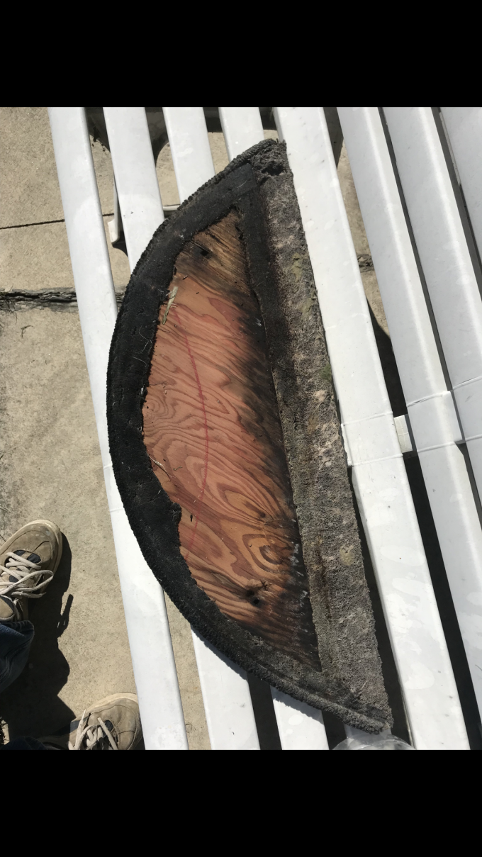

          • jmo
            • Mar 2006
            • 707
            • MA
            I replaced mine with 1/2" plastic - I considered starboard, but I found a large enough cutting board to replace both that was cheaper. The white cutting board doesn't scuff the gel coat.
            I will take a picture of it when I get home.
            On a side note - take the carpet off the old one and use it as a template.

            • jmo
              • Mar 2006
              • 707
              • MA
              Here is a picture:

              • harddock
                • Apr 2008
                • 292
                • toontown E-9
                I made mine out of plastic cutting board material found on EBAY One piece netted two pads. drilled, added carriage bolts with nuts behind and glued marine carpet rolling over the edge 11/2- 2 inches Attached to trailer and done. Should last longer than trailer. Same can be used for crash pads maybe doubled up. Just like the above pictured except covered in carpet.
