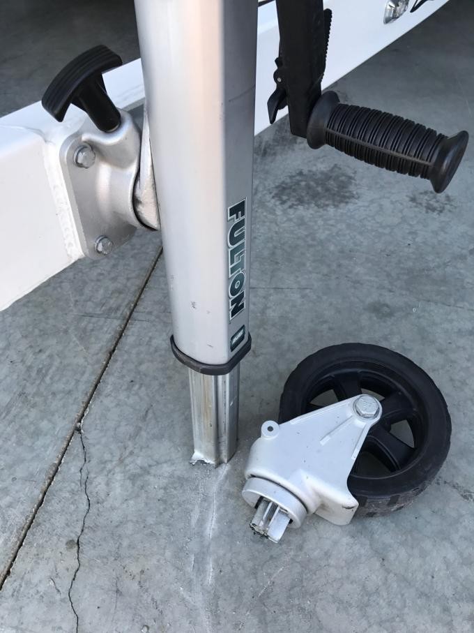

                            We had an F2 jack go as well. Boatmate was really good to work with on it, took care of us, but it was pretty shocking when it went. Could have been bad if someone had their foot or fingers in the wrong spot. Posted this awhile back in another thread, but here is what it looked like.

                              Stopped by dealer today. New Boatmate G23 trailers are now coming with the black Dutton-Lainson jacks. Must have had too many failures with the Fultons.
