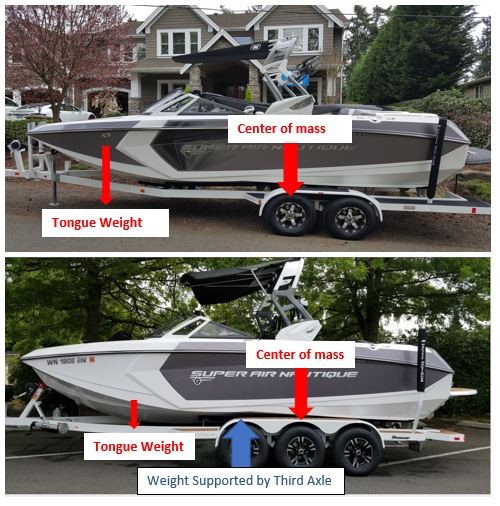

                      Here are two pictures of a G23 sitting on tandem and triple-axle trailers. With the tandem trailer the mass of the front of the boat weighs down on the tongue. This is indicated by the long red arrow. The tandem trailer is designed so that when the boat is loaded to the stops there is sufficient tongue weight to eliminate sway by keeping the center of mass in front of the rear most axle.
                      Click image for larger version  Name:	Tandem vs triple axle.JPG Views:	0 Size:	93.6 KB ID:	597127
                      The picture of the triple-axle trailer shows the front most axle is much further forward on the boat. This third axle DOES SUPPORT additional weight of the boat, weight that is NOT supported in the tandem-axle design. The weight supported by the third axle is no longer placed on the tongue. It is therefore IMPOSSIBLE for the triple-axle trailer to have the same tongue weight as the tandem-axle design. Or are you saying the front axle is floating in the air and not supporting any weight???
                      I no longer own any trailer and keep my boat on a covered lift at the marina. And I do have a Raptor. As you know it has a soft suspension and when I was towing with the triple-axle trailer there was no substantial squat on the Raptor. This was shown in the prior post. The Raptor towed the triple-axle much more comfortably than the dual-axle. If you were told differently by the trailer manufacture you spoke to someone that is not an engineer and clearly does not understands basic physics.
                      Anyone that has a triple-axle trailer with the boat properly loaded on level ground can crank down the front jack and rotate it up. The trailer tongue will hang in mid air because the third axle is supporting the front of the boat and the tongue CANNOT hit the ground. With the tandem-axle trailer the tongue will fall to the ground.
                      So tongue weight is much lower when using a triple-axle trailer which has a front axle supporting additional weight of the boat that is no longer placed on the tongue.

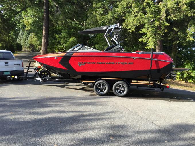

                        here is a G23 on a boatmate with proper axle placement. See how the axles are further forward, and places your center of mass at the center of the axles? The center of the axle group on my tandem trailer is in the EXACT same location as the center of your triaxle group. At proper hitch height (16”), that will place the same tongue weight on the truck. The only difference will be- if you are towing with your hitch height too low, you will have less tongue weight, and if you are towing with the hitch too high, you will have more tongue weight.
                        it is pretty clear that most of your problem was incorrect axle placement on your tandem axle......

                          You really like to dig yourself a hole. There was no problem with my tandem trailer axle placement. I measured the tongue weight, it was shown in post above. For an 8,000 lb load the tongue weight was 675 lbs. This is 8% of the load on the tongue. Well within the limits EVEN YOU RECOMMEND.
                          Moving tandem axles forward on the trailer will REDUCE tongue weight. It is possible your tongue weigh will be lower than the 7-10% safe limit for a single or tandem (close axle) design. BUT this also places more weight BEHIND the rear most axle, increasing the likelihood for sway. Furthermore it looks like your boat is improperly loaded, not even sitting against the stop. This further introduces the possibility for sway.
