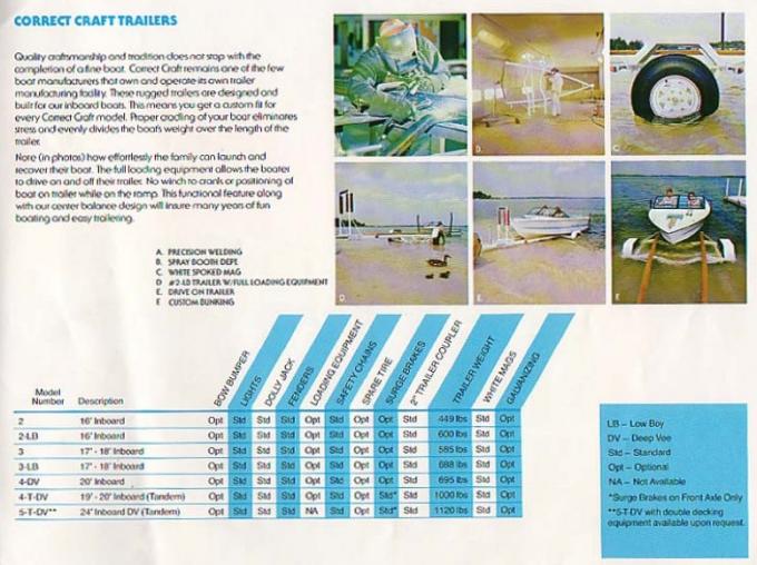

That would be a Correct Craft #3 trailer.
Back then, there were no prop guards.
It does appear that someone has moved the bow stop pretty far back on yours. This was probably to reduce tongue weight on a severely-undersized tow vehicle. I would move it back to the stock position ASAP.
Here's the trailer info from the 1982 brochure.
