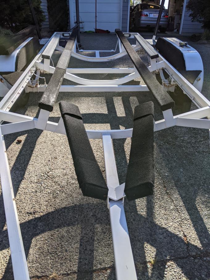

      Picture of my bunk setup.
      In the first pic, you can see the extra carpetting I just stapled on to recover the thin pressure points. I'm in the process of updating the primary bunks to gatorbak.

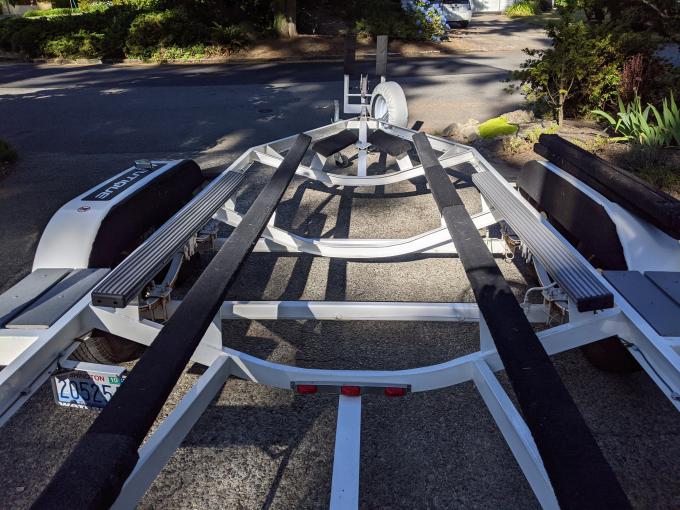

            OK. So the gatorbak's been in for a while and - short of the initial purchase price - I like it. Boat seems to load fine and it's got to be a better than my carpet for not retaining sand and grit when the trailer sits outside with no boat. Just rinse it off and it's pretty clean and good to go.
            I still haven't done the v-berths in front but plan to redo those bunks over the winter. Here's a few pictures.

              Bit of an update on my gatorbak.
              I finally did the forward bow v-berths. And I really like how it loads with the gatorbak installed. Before, it was very difficult to pull the boat into the berths and you just cringed knowing the carpet had glick in it scuffing the hull. With the gatorbak, there's a lot less friction in the bow and the boat loads a lot simpler.
              So - now all my berths have gatorbak (except the foward vertical nose stop which will remain carpet) and I have to say I'm a fan. Looks good. Easy to clean. Loads better. Seems to protect from scuffing much better.
              The lower (apparent) friction now has me looking for a secondary safety strap / turnbuckle for the bowclip.
              Four of five stars. Would need to be cheaper to get that 5th star...requires a lot of first borns to obtain. Gatorbak does have regular sales...would recommend trying to get on one of those if you can.
